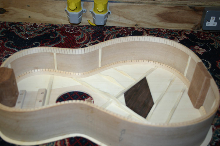

I snagged a bracing scheme from the MIMF and took it to a copy shop and had it blown up full to size. I don't know how faithful it is to the original, but it makes a nice guitar.

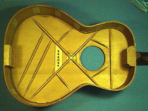

Andy, here is a Gibson L-00 bracing, about the size of what you are talking about. Take a look, 2 tone bars, 1 finger brace, 1/4 inch brace stock.

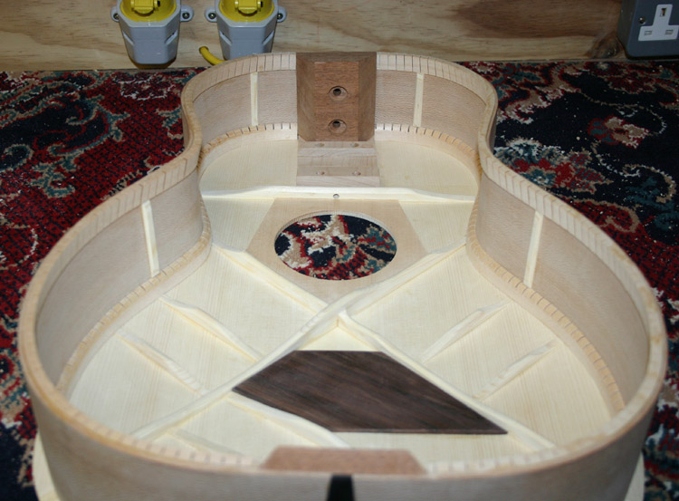

Hi Andy
On my O Size I use a double Tone Bar and Double Finger Braces. I sort through for tops which are more flexible than I would usuallt use.
My Bracing is like this
